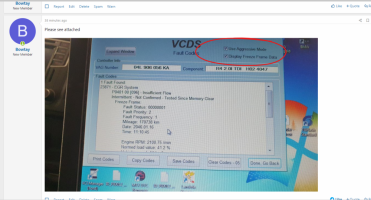

Drivable not a problem pulls like a train just the fault code the rough idle on cold start and the loud turbo stall flutter when revenge at standstill

Any ideas on vcds scan or block measurements that might show anything up?
Reactions: mmi
I have the sister van to this ie same engine I have checked pretty much all live data on tickover and foot down on standstill all pretty much the same I work on fords mainly I have done software updates and have had some good results wondered if it's the same with may need a ecu update

Just to confirm what's already been mentioned, the fault code is pointing to a blocked EGR. Your 3 options are replace EGR, a VW EGR flush or get it mapped out.
That will clear the fault code and maybe resolve the lumpy idle on cold, but there are no guarantees it will resolve the lumpy idle, just that it will fix the fault code.
