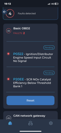

Code on Carista is P0322
13184 = P0322 - Engine Speed Sensor - No Signal
no codes apart from EGR( 15560 )

Sorry just reading this as I have a similar intermittent fault . When It happens I have code 13184 and p0322 . Sometimes engine cuts out other time is hesitant and revs jump up to 2000 on idle . Then when I clear code drop back down to normal . Would this also indicate crankshaft sensor ? Would you have a part number for this . Mines a 2017 5 speed manual .

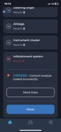

Monday left drive way to go to work , coil light came on and stayed on all the way to work but ran fine . On way home ( no coil light) did 3 miles then I filled up with 40l of Vpower , joined motorway shortly after had juddering and coil light came on - idle increased to 1200- plugged in when I got home had the below . ( had some extra random faults hence why I thought battery )
Anyhow just had a battery / alternator test today , Kwik fit.thought this could be the issue - its reading at 12.3 , increase to 14.4 when engine on . Ran smoothly back and to station ( 4 mile journey) he told me to trickle charge battery for 4 days - run for a week and then he ll retest it before forking out for a new battery .
Also when I got home after yesterdays motorway fault the battery was reading 12.9v while idling - the same when I cleared the faults and 12.4 when engine off .
