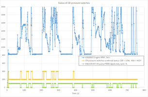

In the graphs the status of oil pressure switches (closed/open) is combined to show oil pressure states. Thus value 200 basically indicates oil pressure somewhere 0.3...2.3 bars, and respectively 400 indicates oil pressure above 2.3 bars. Also graphed is control signal of Oil pressure regulating valve (this far only values 0/100% observed).
Each dot in the graph represents a data point in the recording.
Picture 1.​

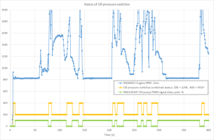

EDIT: picture replaced to show more "bumps"
The bumps 1 and 2 by just flooring the pedal quickly. The third by gradually (slowly) increasing revs - note no change in green/orange.
IDE00021 Engine RPM
IDE00497-MAS00627 Status of oil pressure switches-Oil pressure switch for high pressure
IDE00497-MAS00628 Status of oil pressure switches-Oil pressure switch for low pressure
ENG130437 Oil pump PWM signal duty cycle

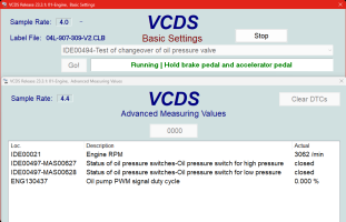

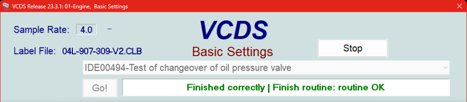

VCDS Basic Settings - IDE00494 - Test of changeover of oil pressure valve​
T6 Engine controller has a dedicated test to verify operation of oil pressure regulator. The test runs engine for 10 seconds at 3000 RPM and commands oil pressure to "high" full time of high revs (unlike normally just for a short burst seen in picture 4).
Picture 5.​
If the test fails I would expect to see something else than - routine OK? Please report back!
A detailed example how to run and record the test (Basic Settings)
  • Attached a VCDS measurement setup file TEST_OIL_PRESSURE_REGULATOR.u01 - remove the .PDF extension so it will become a VCDS compatible .u01 file.
  • Alternatively can also tick the parameters individually

Please compare with picture 4 (my post #1, now edited to show more data).
