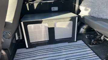

Has anyone made a low table / portaloo storage unit ? Basically a box with a removable / hinged lid.
I’ve made this unit/pod for my van - it’s not to house a sh1tbucket, but you could easily (I never find this stuff easy but I mean it would only be 4x aluminium corner profile and some furniture board the same as your van furniture) make a small box the same way and use a table top for the hinged lid - this is a 900x500 table top. It is probably the right sort of height at 480mm.
Thanks for that, yes that’s the type of solution I’m after. I will keep it portable so I can put it outside/in awning.
