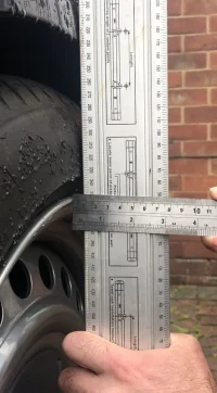

Here is a pic of mine. Be great if others who are not getting rub can compare?
But this doesn't explain why @Tourershine and @T6180 are so different at they are both T32.
I know that based on others experience you shouldn’t expect to be rubbing, but just a thought, is it rubbing on the upper most arch liner screw? If so, try removing the screw, pushing the liner behind the mounting tab and bending the tab up a little. It might cure your rub.
No, its rubbing on the arch liner in front of the wheel towards the centre of the wheel arch. I will get some pics of where. On pretty much full lock.
