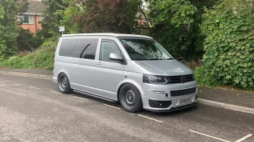

Anyone got any photos of a pure grey t6 with banded amoraks, I’m having my van painted pure grey and currently have banded amoraks but I’m thinking I might be looking at either new wheels or wheel colour change( silver at the moment ) preferably low as I’m on solows.
Get it dropped down to 80mm mate and I’ll bet it’ll be fine.... the extra lower camber should just be enough for your sliding doors. :thumbsup:
This was my plan. Get it lowered hopefully get some extra camber and sort the tracking out. If that doesn't work I will probably try some 235/45r18 tyres.

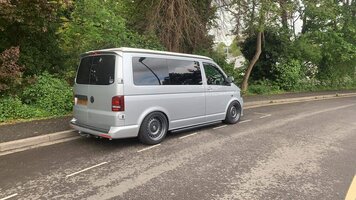

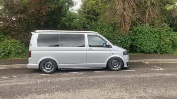

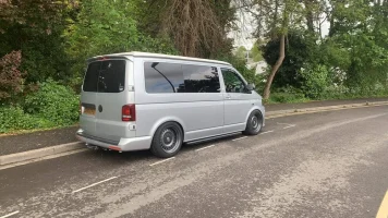

That feeling when the tyre fitter calls over two of his colleagues to look at your brand new wheel on the tyre machine.
To$$er completely ignored the fact I told him they were different widths and didn’t readjust between the 9 & 9.5 and damaged the lip. So angry. Anyhow I had no choice but for them to finish the job so I can handover my current wheels tomorrow.
Already on the case with Jamie to repair.
Fitted to the van now. No rubbing as yet but the sliding door catches. However it’s a Kiravans store panel so I may be able to remove that and get away with it.

Agree, they look great, but bloody annoying for you that they did that!
