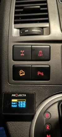

btw, we've got Success here - a light to the button comes )
when Button pressed then ABS unit opens GND (ground) at pin /14 (but not +12V as expected)
and +12V for Button indication we take from KL15 (ignition ON)
Everything works. This is resprayed and laser cutted 6pin PDC button on the photo.
This might be useful for those of you who have no HDC lamp on Instrument cluster (like me hehe)
