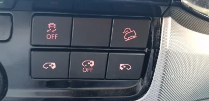

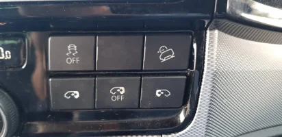

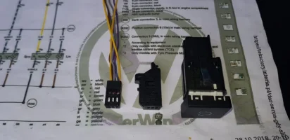

To tell the MK100 ABS from T6 that the ASR Off Button is equipped, you have to change Coding of ABS BYTE 15 Bit 6 from 1 to 0.
And of course you have to wire the ASR Switch like in the Schematic which you can get officially on the VW Erwin Portal.
I tested it on the Bench and it works.
To test this on the Bench a quite bigger Setup was needed:
Wiring is very simple. All you need to do is to connect PIN 4 and PIN 6 from ABS unit to TCS switch contacts. And then steal illumination from one of neighbouring switches.

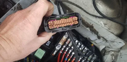

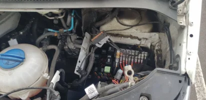

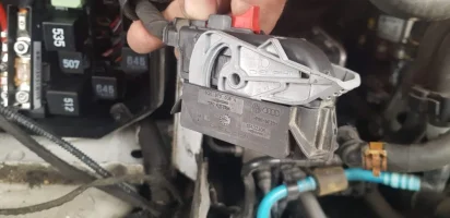

Pin 4 on ABS is the Input
Pin 6 on ABS is 12V (15a) which can easier be stolen from the Start/Stop Button Pin 2 or Pin 4 for example
Are pins 4 and 6 currently used or are these new wires to add?
