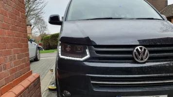

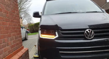

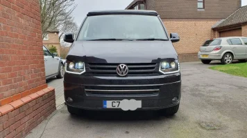

Having been disappointed with every LED bulb in dipped beam, I came across these whilst looking at upgrades for out Polo's headlights.
I feel I've just about tried every option for these lights and concluded that HIDs get the best from them, however, if someone would like to give them a go and report back...
So here they are in travelin-lite light.
they are brighter and have a wider beam than the philips led I replaced then with.
No warning lights on the dash and no loss of dab1613250961037.png1613250822473.png
No warning lights on the dash and no loss of dabView attachment 103525View attachment 103524
I think you need to check the bulbs are fitted correctly as there's something weird going on with that light pattern (and I don't mean the different heights between the OS and NS lights). You appear to have a second 'kick up' extending above where the cut off should be. It almost looks like you have two sets of headlights - one set of projectors and a second set of reflectors.
thanks for the advice will have a play with the bulbs
