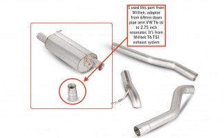

they are all same TDi TSI....
you will just need the adapter from Miltek.
Adapter between Down pipe and center box.
I kept it when I sent back the Miltek exhaust that was much too noisy and drowning

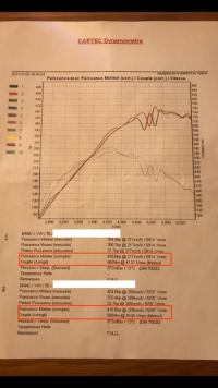

Nice HP numberJaro.
But why do they keep the torque so low at low rpm?
Maybe you have 2WD and that is why.
I have 4Motion and get 585Nm max and already at 470NM at 2500 rpm and 530Nm at 3000rpm.
My best 1/4 mile until now 13.94 s but I don't have Launch control activated yet?
Maybe 13.6 or 13.7 when I get the launch control activated.
I have a turbo hybrid from turbozentrum it's a bit smaller than TTE450.
Since my van was new I always go to the same Dyno for each stage.
Oem, Stage 1 , Stage 2, Stage 3.... so I have same base.
It is not the dyno from my tuner like that it's more neutral. But I get about same number on the Dyno from my tuner.
Here a Dyno from my Van. We have to pass it in 2 wheel drive (unplug haldex fuse) because the LWB 4motion is too long for the most Dyno's
this day it was sleeping on the dyno. why the bump at high rpm. the operator did not tight is well as he did not expect a T6 to make this kind of power.
I pay 50 euro each time for 2 pass on the Dyno.
I have to go back their with the new mod to see where I'm.
