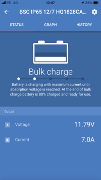

I think my starter batt is on the way out. It is normally trickle charged from my leisure batt so usually sits around 12.3V when parked.
I thought I would give it a charge today connected directly to a Victron 12/7 smart charger. In bulk the voltage is rising to circa 13.2 and then dropping back to 11.8 before repeating. There are no loads connected.
Does this indicate a failing battery?

I use both pieces of kit on mine. Never seen it climb to the 13.27v and drop again it just stays at 13.3v - 13.5v and stays there until the float kicks in. What happens if you just run the engine? Mine will climb right up to 14.8v and charge until it reaches a certain level, gradually drops to 13.5v - ish and the stabilises.
Then the Euro6 setting kicks in and only charges the battery when you brake or slow down and will peak to about 14.7v for the period you are slowing down. It was explained to me by @travelvolts the the battery will only normally charge to 85-90% and the peaks generated from slowing down just keeps it topped up.
If I run the engine it charges as you describe. I cannot fathom why it fluctuates the way it does and it has only done this since I switched the leisure batt to lithium.
I assume you have a DC-DC charger for the lithium leisure battery charging and are not just relying on a split charge relay?
