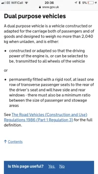

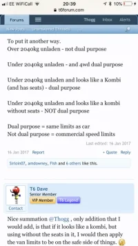

A Kombi is a van UNLESS it meets the requirements to be dual purpose in which case the higher limits apply.

Out of interest, of approx 43 variants of the Kombi I think only 12 would qualify as Dual Purpose because of the weight limit of 2.040Kg unladen.

It shows mass in service which includes driver at 75kg and 90% full fuel tank. Subtract 130kg from this figure as said earlier in the thread to get an approximate unladen weight or take it to a weighbridge almost out of fuel and without you in it when weighed for a more accurate measure.
I remember going through the weighbridge test when I first got my Kombi. I went with the seats removed and an almost empty tank but it still got nowhere near the magic 2040kg. It’s a 150ps 4motion Highline. I think basically if you have 4motion you are stuffed because of the weight of the extra mechanicals
