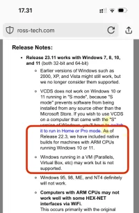

Thanks for the warning, have to admit I hadn’t even thought about that. Here’s what RT says about the subject:
