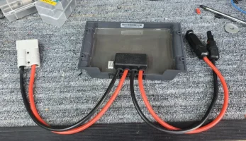

personally i keep
MC4 for all solar panels, extension leads, interconnectors etc etc ,
and use Anderson
SB50 connectors to the Power side of things. .
that way its impossible to connect any thing up wrong as everything is keyed correctly, so solar will only connect to a solar input and SB50 will only connect to the Power side.
so all my solar pv side stuff is MC4, that way any controller will connect to any extension cable that will connect to pv panel.
and same on the power side, i make up fused SB50 connection on the battery, then any SB50 extension cable can be used to any solar controller. etc et c

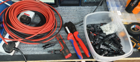

- MC4 tool - yes and no, for the spanner bit, you could prob do the connection tight enough by hand - but once clicked together, some of the MC4 connections are next to impossible to undo without the two prongs bit of the tool . . . especially when its cold out.
there are loads of MC4 plugs that all vary slightly, same with the tools . . they are all slightly different. so id suggest getting a MC4 tool to make like easier.
i make up all my solar controllers so that they are plug and play using MC4 and SB50 with flexible 8AWG silicone cable

and MC4 leads. . .
Mc4 tools. .
