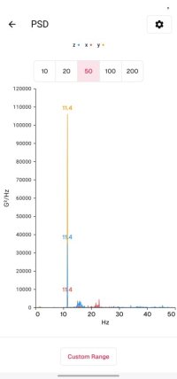

Vibration 2023 4M, Cali, 15k km

At or aroudn 85 km/h it always vibrate in 5,6 or 7:th gear as well as uphill power mode or downhill coasting.
Ok, proves the Haldex engagement is not the cause for the vibration - as at around 85 km/h on 7th gear it's fully locked, and on 6th gear no engagement at all.
