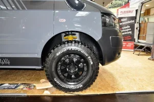

Hmm, is this what we're talking about? just found these...
That kind of thing.

I've got to honest, I like the 'off road look' as much as the large wheel/lowered look, but I'd probably be just as paranoid that those knobbly tires where creating extra rolling resistance/drag/noise etc. Where does it all end? Lol.
@Mojo - Quite a few aren't too knobbly - the Michelin Crossclimates on our Subaru Outback are fairly quiet but work in ice, snow, rain and (some) mud.
One T25 I saw had a Subaru 2.5 engine (same as our Subaru car), was raised, has custom chassis and brakes made up and looked ace. Proper off road adventure mobile.
And a German Sprinter conversion - again raised, on hardcore tyres, snorkel fitted and loads of kit. Proper Apocalypse vehicle!
