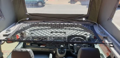

Thanks. Yes, was pleased with the outcome, particularly as it takes up no storage space itself. The pole retracts and then you just bundle it behind the lip at the front of the roof bed. The net on its own would be good enough to take bedding I think, but I added the metal bar so I could stow storage boxes up there too.
Spent a while finding a net the right size, so that the tension was sufficient: Haofy Cargo Net, 100 x 40CM Car Boot Net Adjustable Elastic Trunk Cargo Organizer Nylon Mesh Rear Car Net for Car, Van, SUV, Truck Bed, with 4 Hooks
Haofy Cargo Net, 100 x 40CM Car Boot Net Adjustable Elastic Trunk Cargo Organizer Nylon Mesh Rear Car Net for Car, Van, SUV, Truck Bed, with 4 Hooks: Amazon.co.uk: Car & Motorbike £17.29.
I glued and screwed (Gorilla glue) two of the round fixings to the lip of the roof, staying away from the outside edge of the roof bit as there’s van wiring in there!
I only glued the front two hooks as I felt confident then that the glue was strong enough on its own.
I glued another couple of hooks along the front edge to stop the net drooping in the middle: ProPlus 342150S Cover/Tarpaulin Hooks Round Plastic, Pack of 10 £3.97. ProPlus 342150S Cover/Tarpaulin Hooks Round Plastic, Pack of 10: Amazon.co.uk: Car & Motorbike
I used a black extendable shower rod (85-150cm) as a bar to prop up storage boxes: Frenessa Metal Extendable Shower Curtain Tension Rod with No Drilling Required, Telescopic Cupboard Bar Adjustable Pole Rail for Net Sheers Voiles Wardrobe Bookshelf Cabinet, 85-150cm, Matte Black £11.99.
Frenessa Metal Extendable Shower Curtain Tension Rod with No Drilling Required, Telescopic Cupboard Bar Adjustable Pole Rail for Net Sheers Voiles Wardrobe Bookshelf Cabinet, 85-150cm, Matte Black: Amazon.co.uk: Kitchen & Home
The storage boxes were chosen to fit both in the boot and to sit 3 abreast on the new rod/net shelf
Wham Plastic Storage Boxes - Pack Of 5 (32 Litre) £27.38
https://smile.amazon.co.uk/gp/product/6040194316/ref=ppx_yo_dt_b_asin_title_o06_s00?ie=UTF8&psc=1
Hope that helps!

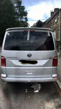

Quick mod today. My van's bumper has looked like this since new and it's always bugged me
So today I knocked up these
Job done. Yes I know some would think they'd look better in black, but I like the contrast and the van is grey. And I didn't have any black filament.
