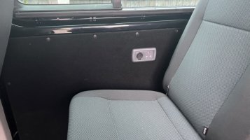

Sound deadened and insulated inside the final panel (solid panel opposite sliding door), cut holes for CBE sockets, carpeted and reinstalled.

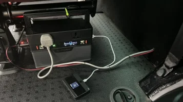

Wired up the CBE sockets and fitted to the panel along with the 240 and 12v connections to the AllPowers.
Still got to wire an ignition live to trickle charge the AllPowers and install the LED lights in the ceiling (wire already run and behind roof panel).

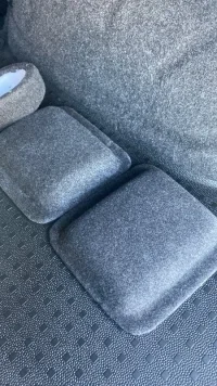

Next up will be the ‘under Kombi 3 seater bench’ storage, rear speakers and enclosure for the AllPowers and Wi-Fi box.
