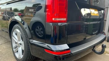

Noticed a 2” long blemish (circled in pic) on the rear near side panel under the rear light when washing my van yesterday - the paint was rubbed off and I could see the plastic panel underneath. No idea how/when it got there but don’t recall rubbing against anything.
I could have easily touched it in with a cocktail stick/small brush and you’d never have seen it, but inside decided to remove the panel, lightly sanded around it, masked up along the body line that is along the bottom of the panel, sprayed with base, clear lacquer next and then thought I’d be able to polish out the blend along the bottom of the panel.
F’d that up, so decided to lightly scuff the whole panel and clear lacquer it.
F’d that up too as I got a run in the lacquer and some of it looks as rough as an elephant skin. Decided to wait a couple of hours for it to go off, then used some Farcela G3 compund to try and remove the peel and run.
F’d that up as well as it is still pretty peely, so reinstalled the panel and came indoors with the hump.
I will try to wet sand and machine polish when fully cured or more likely will get the panel professionally painted and lacquered when I get a rear spoiler painted![]()

Looks goodFollowing on from me with the hump yesterday as I messed up, today I have managed to wet sand and polish the panel to a reasonable finish - crisis averted anyway and compared to how it finished up yesterday it has worked out OK….
Still think I should have just touched it in and moved along![]()
