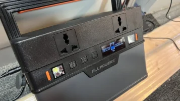

Does yours look like this?Troubleshooting.
Fuse blew on my wire that runs from the ignition live fuse in the centre row of the fuse box to the DC5521 plug that plugs into my AllPowers battery bank thing to trickle charge it.
The same wire also runs some red LEDs in the back of the van - which is how I noticed there was an issue - they were off.

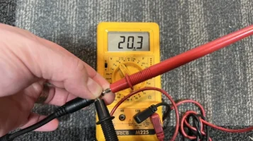

Got my multimeter out and confirmed fuse had blown, disconnected both the DC5521 plug from the AllPowers and the cable powering the LEDs.
Replaced fuse, ignition on, power getting to the plug. Reconnected the AllPowers and looked at the charging indicator - no watts coming in.
Reconnected the LEDs and they worked too.
Took the AllPowers out of the van and in the garage I connected the mains charger (after checking it was giving out a voltage) and the same issue - no charge watts going into the unit.
So I assume that the charging circuit has popped which took out the fuse - now it’s dead
Went onto Amazon and sent the seller a defective item message - so we will see what they say.
I had my doubts about these chinglish battery packs and an all in one unit with an inverter seemed too good to be true - wish I’d installed a Victron dc-dc charger and leisure battery instead![]()
And if so have you checked the 2 fuses under the flap above the word ‘Allpowers’ in the pic?

Thanks will do.Have a look on Google. There’s a couple of vids on YouTube-one where a guy strips one down and the two fuses are inside.
Obviously if you can get a straight replacement great, but if you get nowhere it’s worth a try with the internal fuses.

The seller has responded via Amazon Returns and asked me to charge it up via USB-C and then try the AC DC5521 charger again
I did as they asked but unsurprisingly this has made no difference. Sent them a reply to that effect and these this afternoon…..
