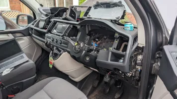

Finally took the plunge and removed the dash and radio wired in rear speakers, left and right work perfect, just need some help when I get chance to get the fader programmed
Not too bad a job just need to be brave with the dash ..
One bit advice always have a TE extractor tool incase…
Oh and dropped on door seals what a difference
Next job upgrade then headlight and fog lamp bulbs
