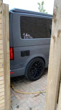

What tyres are you running?
255/35/20, bit lower profile than I’d like but using the Will They Fit website they’re almost the exact same circumference as the original 205/65/16 tyres meaning the speedo is only 0.5mph out at 30mph. Other sizes are up to nearly 3mph out and I wanted the speedo to be as accurate as possible.
