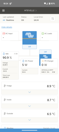

Fitted the Cerbo GX today! Only plumbed in the MPPT 100/20 so far, it works!
VRM portal sorted too! Van wifi (thanks be to @TallPaul_S )

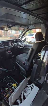

Tomorrow the S4 Roamer 230 (upright not seatbase) turns up, that's going under the wardrobe where my existing gen 1 Roamer lurks now.
The rest of today will be fighting with the removal of the passenger seat to get the XS50 under there, and run a long VE Direct cable through various rat runs back to the LB.
Not a difficult mod, scariest bit was the hole cutter drill part through the wardrobe side.

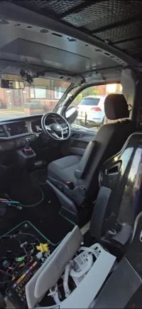

Yes, it's on my phone and my kitchen table tab!
I now need those Ruuvi tags don't I! Bet they're not 2 for a fiver! It really never ends does it!
Nope, lol. I've got 2 of the std 'indoor' ones, and a pro version which is waterproof for exterior (it's in my fuel flap).
There's also a wireless water tank sensor I'll probably add this year, they're not cheap either! :rofl:

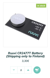

Not sure about that but if you do add some wide temperature range batteries on the same go. Their batteries do actually last pretty well but outdoors / fridge / freezer will eat them early and the size they use is surprisingly hard to come by even as a standard CR2477 version. CR2477T is the wide temperature range one.

I got mine from ruvvi direct as it came to over 100 euro which meant free shipping. You can't get the batteries from them though (Finland delivery only), and they'll be cheaper from a UK seller if you need to pay for delivery.
Naturally you're correct, many cr2477's around, but the only genuine ones I found were these.. a lady Godiva each...
Ah damn sorry, the official shop ruuvi.com delivers tags worldwide but batteries only to Finland due to lithium. They are reasonably priced in the shop so that's why I suggested it without realising the delivery restriction.
