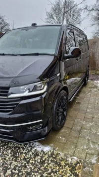

Changed the standard black wing badges to match my teal colour trim sprayed by myself well pleased.
Black side indicators
And of course black high level stop lights …
Plus a little winter wash
