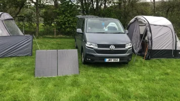

Solar Panel: None yet.
Mobile Panel: Renogy 200W Foldable solar suitcase
Solar charge controller: SmartSolar MPPT 75/15,
DC-DC charger: Orion-Tr Smart DC-DC Charger
EHU Charger: None
battery bank: 100Ah Renogy Smart Lithium Iron Phosphate Battery
Battery Monitor: Victron BMV-712
Inverter: None
other: Click here for 10% off Renogy

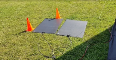

Solar Panel:
Mobile Panel: 2 x 150w xplorer (rigid)
Solar charge controller: Ctek D250sa
DC-DC charger: Ctek D250sa
EHU Charger: see other
battery bank: 110ah Aventurer AGM
Battery Monitor: Vitron smart stunt 500
Inverter: n/a
other: Maypole EHU Reel ..( cable connects to fixed cable from bonnet to under passenger seat ) so can disconnect to use in either the van or tent ( cable lengths have been adjusted ie short cable on reel)
Edit….additional 110amp Agm in box. solar now mounted on trailer ( on location ) also due to limited space will replace Ctek with REDARC system as on going project..( if it’s good for our Criminal Cousins ..then that’ll do :laugh: )

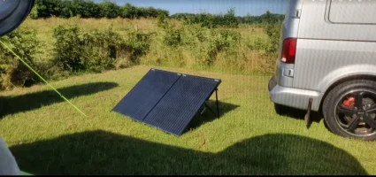

Hi,
the controller it comes with is a charge controller, which is supposed to be good but not as good as an MPPT.
I have a victron MPPT so unplugged the MC4 connectors on the back of the panel and ran some solar cable fitted with MC4 to the MPPT in the van.
SO if you have an existing MPPT in the van I would connect short wires (maybe 30-50cm) with either Anderson connectors or MC4 then have a 5m extension lead with the correct connectors to connect the leads on the back of the panel to the short wires fitted to the MPPT.
ANother idea I had was if needed you could connect 1 panel of the suitcase to the leisure battery through your MPPT. The other panel could go to starter battery using the panels solar charge controller.
I will try to remember to take some photos tomorrow if you want.1DA07CF8-3F56-4B1E-9BB6-9600E756E74C.jpeg
