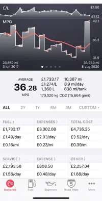

I'd just like to be able to, "drive all the way back from holiday at 70mph, fully loaded", and return 40 plus mpg like so many others do.
That's not correct. The radius (distance between the ground and the wheel centre) determines effective rolling circumference and a completely flat tyre would have to rotate more times to cover a fixed distance than the same tyre inflated, therefore it would affect the speedometer.even with a completely flat tyre the distance around the outside of the tread is the same (the rolling radius will change but that wont affect the speedo)
What app is that?To (perhaps) add some confusion to this thread, I’ve just driven from the south-east to Scotland in a fully-loaded camper (and I mean fully loaded - with just me it weighs 2400kg, and I had three passengers and a load of luggage) and got the best MPG yet: it’s gone up from an average 33mpg to 42mpg.
