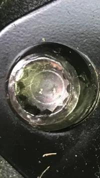

I just used Dynamat on the wheel arches inside the van, not under the wheel arch liner. Do a neat job and its less faff and you can not see its been done.
