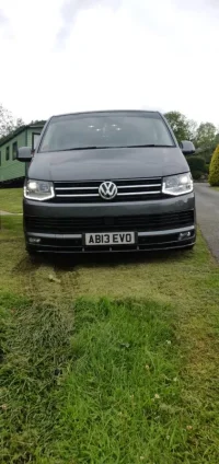

I've been looking at buying new headlight units that incorporate the VW/Audi style led Drl's and sequential indicators. I've seen some on the road where the individual LEDs in the drl's are clearly visible (which I dont like) and others where it is more of a continuous strip light. Its difficult to tell from pictures which ones are best, any recommendations on here?
Also which give out the best light as I'm struggling with the standard headlights.

I'm weighing up options too. Having read all there is to on here and then reading the rest of the internet, other than OEM LEDs, the only lights out there are the ones sold by THQ.
Travelin lite sell the same lights with LED bulbs in the projectors for £620, so they are an option too. I'm hoping there will be some to look at at Busfest, as whilst they look good in the pictures, I'd like to see them in the flesh. At the moment I'm preferring the V1's as I don't like the look of the LED indicators in the new ones.
I'm also considering fitting bi-xenon projectors into my H7's for a lot less money.
Bulb monitoring can be turned off using VCDS, so warning lights can be overcome whatever you choose.

Just had a set of the black v2 lights fitted by Transporter HQ. they look good and have better light output than the standard H4 s..... great service from the guys there as well. They had them fitted in 30 mins.

Given you already have H7 lights, I wouldn’t expect the THQ ones to be a big improvement in actual light output. It’s moving from the H4 lights where you get huge improvement.
