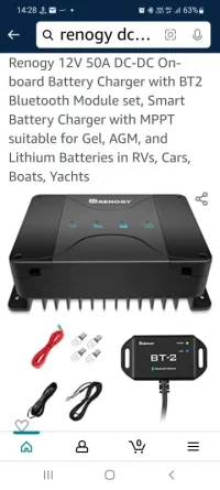

I use the Renogy dc50s for dc-dc charging, with a lithium. (, With the app)
And even though it does solar, that splits the power 50/50 when you add a solar connection.

They are cheaper but lower charge rate. The 50amp charger is compact, high current but only available with solar, the 60amp charger without is much bigger.

the cheaper Renogy blue units have cooling fans, the MPPT versions are fanless.
( i have both )
