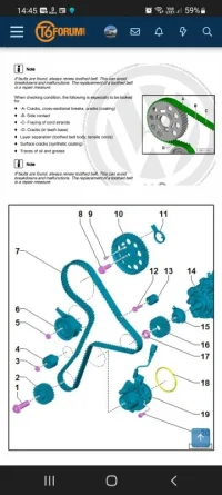

Manually reset the timing with the timing pins check the high pressure fuel pump is also correctly timed (Page 99 of the attached)

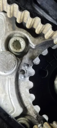

Afternoon guys checked the timing there on the van pins are going into the cam and crank pulley ok but the pump pin is not lining up its atleast a couple of mil out where I cant get the pin in, I've attached a few pics. Would this cause a non start ? Thanks
Looking at the cam you should try and get the pin in the centre of the elongated hole. Are you sure the crank is lining up as it should? Everything needs to be lining up. Worth spending time getting it right.
