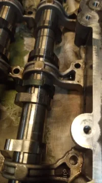

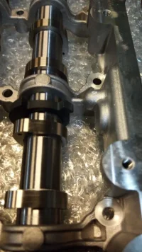

I installed new camshaft module. 00182 shows 3.0 degree.
Now engine allmost starts but wouldnt stay on with all cylinders
old camshaf module was bad. timing was maybe 10-15 degree ahead for some reason.
pic shows old and new one, both locked same way.
