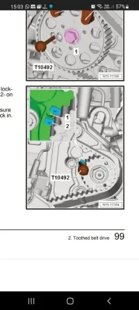

Won’t start. No fault codes
Quote from WSM. (Download above)
Lock high-pressurepump hub with diesel injection pumplock‐
ing pin- T10492- . Todo this,insert lockingpin intofork -2-on
hub and into hole -1- behind it in bracket for ancillaries.
– Pull out locking pin, and slightly loosen nut for high-pressure
pulley. Before loosening completely, insert locking pin back in.
Looking at the cam you should try and get the pin in the centre of the elongated hole. Are you sure the crank is lining up as it should? Everything needs to be lining up. Worth spending time getting it right.
Hi Chris thanks this is the way we got the van back from the shop, i will certainly spend more time at it to ensure its all linned perfect thanks
thanks again dellmassive, this is the way we receved the van from the shop. i was just checking all the marks lined up this morning the only pin i cant get in is the pump pin as its aleast 2mm off to the point were i cant get the pin inserted. bassed on the diagrams you kindly sent i can only assume the pump timing is incorrect just wondering if this a possibilty why it wont start ? im sure its vital this pin should go in, i will get the belt off in the coming days and refit

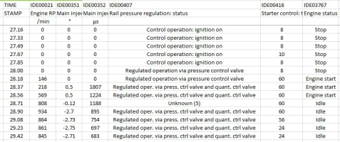

good afternoon guys vcds has finally arrived so I've done what @mmi has said this is the file hopefully sheds some light on this thing
Thanks,
Question: was the engine cranked immediately prior to creating the map - just curious because main injection timing was at 0.5 degrees (normal startup initialization), however injection duration recorded is 0.
IDE00351Main injection: start of activation0.5°
IDE00352Main injection: duration of activation0µs
To me a suspicious one is the below - the few engines (almost 20 now) I have checked this have been -1.3 to 2.2 degrees.
The non-starter mentioned earlier (post #8) was 6.6 degrees - after readjusting 0.9 degrees . Another non-starter had 3.3 degrees, however the guy never returned with feedback so can't confirm that one.

It should give us an idea that basic things are happening - cranking speed, air flow, fuel pressure, injection, etc.
Tick the following in VCDS > Engine > Advanced Measuring Values,
IDE00021 Engine RPM​
IDE00347 Air mass: actual value:​
IDE00351 Main injection: start of activation​
IDE00352 Main injection: duration of activation​
IDE00407 Rail pressure regulation: status​
IDE00416 Starter control: terminal 50 feedback​
IDE00589 Fuel pressure​
IDE03767 Engine status​
IDE07757 Exhaust recirc.valve 1 bank 1: posit.feedback - Actual value​
IDE07771 Throttl.valve adapt. 1 bank 1: posit feedback - Actual value​
IDE07824 Tank-internal presupply pump 1 bank 1: activation​
Tick "Group UDS requests" - by 7.​
Click Log - Start​
Crank the engine - 3 seconds is enough.​
Stop logging etc.​
The logfile will be in folder C:\Ross-Tech\VCDS\Logs​
Please post the logfile.​

Ahhh... that explains there is no airflow (yellow)... wondering if that has triggered a fault? I think it shouldn't prevent engine starting... also marked with yellow the rail pressure regulation status as it should change - e.g. as here
Please note IDE00352 - Main injection duration
I'm not sure if the missing airflow caused that because the other non-starter also worked correctly in that respect here
Please note IDE00407 Rail pressure regulation status
Anyways, I believe why it's not starting is simply because the ECU does not even command injectors to open (the red - injection duration=0). The fuel pressure in the rail is normal.
Just remains the mystery why ECU does not even think about opening the injectors?
PS. The full data in the attachment.
