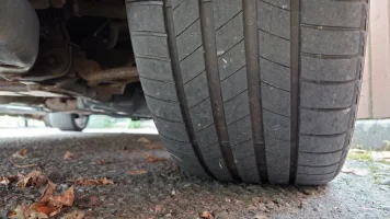

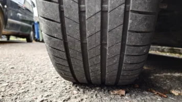

Couple of shots of my tyres this morning. All 4 are Bridgestone Turanza 255/40/20 104, all at 38 psi.
Rears were fitted this January, fronts in February. £220 ish a corner. 1500 miles max since the back ones went on. Rear left seems the worst. Fronts look to be wearing better and more evenly.
Rear N/S
Rear O/S
Front O/S
Front N/S
Wow the rear geometry is way off the mark - eating tyres! I’d be checking all the bushes for any movement and then get a laser alignment done. Keep us posted - Good Luck

Cheers. Laser alignment done a few weeks ago but tyres were already too far gone to notice any improvement. The rear was "out by quite a bit" (their words), but they never mentioned any issues with bushes but said they had sorted the alignment.
Will have to get it redone when the coilovers go on..... hopefully the garage installing them have a 4 wheel alignment system so I can get it all done in one hit.
Yes you do def need an alignment after making changes to the ride ht. Make sure it’s a laser alignment set up. Hope you get sorted.
