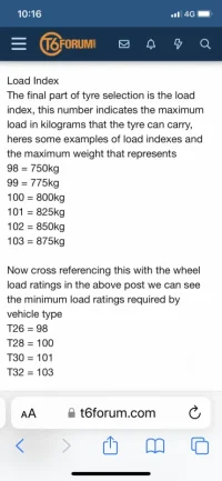

If 275/35/20's are available in 103 rating I'd love to know where from.
Who mentioned 103? 102 rated tyres are plenty for a t28/30 which There’s plenty of. Google 275/35/20 load rated tyres.

Nobody, but saying you can get those tyres "load rated" implies that they are available for all vans when they're not, a bit like saying "Yeah, those shoes come in sizes"
When I read your post I assumed that you knew where to get 275/35/20's in 103 rating for my T32. :)
