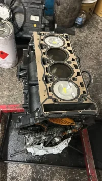

After losing power and the engine shutting down a cylinder I pulled over and called the AA. This was their report:
Patrol found the following fault code/s: System : Engine control 1 - VMV / Motronic MED 17.1 UDS Status P 030000 - Combustion failure detected. Error Message : . Static fault. Status P 030400 - Combustion failure cylinder 4 detected. Error Message : . Static fault. Status P 130A00 - Cylinder shutoff. Error Message : . Sporadic fault. Status P 030300 - Combustion failure cylinder 3 detected. Error Message : . Static fault. We have arranged for a recovery of your vehicle. Engine Oil Level Low - Not Topped Up: On min. Coolant Level Ok.

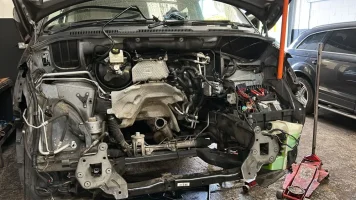

After changing plugs, swapping coils and all other road-side options were carried out, the hope was a failed injector and/or carbon build up. So it was flat-bedded away to get fixed.

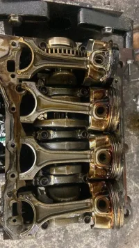

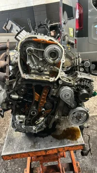

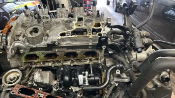

Unfortunately, it got worse at the garage with zero compression in cylinder 4 and all this metal in the sump:
Not looking good at all.
I bought it standard in summer 2020 at circa 29k miles. Now 42k.
The van has been without fault until its breakdown. Journeys flex between very short 3-mile round trips in London, to last summer where it took us to the South of France to Tuscany and back perfectly. Mostly city though.
