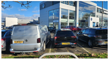

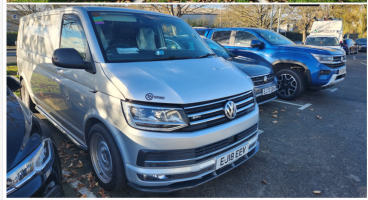

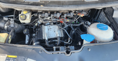

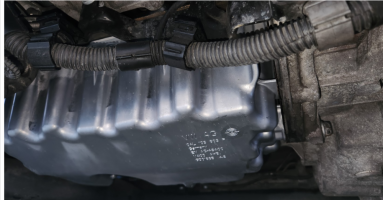

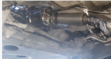

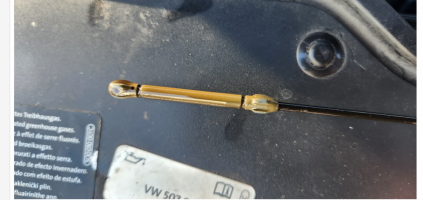

UPDATE:
The day has finaly come. . . . .
from 13th Aug 2024 - to 22 November 2024
14 weeks or 3 and a bit months.
Its Back !!!!!!!

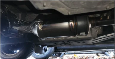

all fixed and shiney. (2018 CXEB 80k miles)
with a brand new CXEB Long Block engine + CAT + DPF + Lamda sensor, - via "All-In" warranty
plus the warranty swap DMF. - via 24mnth Parts warranty
Plus a Brand new Turbo - at my cost.
1733066203606.png1733066219650.png1733066211963.png1733066230366.png1733066240202.png1733066251668.png1733066258642.png1733066273102.png

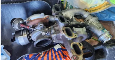

2017 CXEB 65k - small turbo seized solid - replacement turbo and had DPF professional cleaned as a precaution, even though it had no signs of excessive soot. Compression test perfect and no signs of any high oil usage.
Pretty sure it related to poor oil heat management of the CXEB as for me it failed after a 500+ mile, all day drive in the 40 degree French heatwave during this summer and it seized leaving it to cool over night. A month for the AA to repatriate the van back to the UK and then a further 3 months waiting for the turbo to come into stock from being on back order so only just got it back this week.
