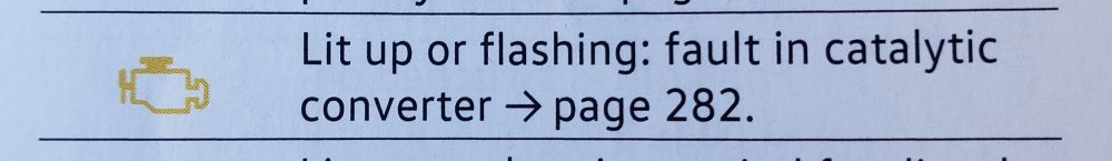

I got the little orange engine light yesterday only way home from a drive to Weston Super Mare. For completeness, here's a picture of the rev counter along with the relevant sections from the manual:
As anybody who has read my previous posts will know, I know nothing about mechanical stuff so it worried me all the way home and I plugged Carista in, it showed two engine / exhaust related faults - P20EE and 31103 (along with 4 others, more of which later maybe!). FWIW Ad Blue was topped off about 600 miles ago.
