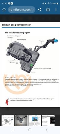

My adblue says I have 6500 miles left in tank but just looked and it’s empty in the neck .
I have dipped the tank and looks like it has about 100mm in tank .
It seams to be using adblue as it was full the beginning of last year but does not count down when it’s been used looks like on the display.
Don’t want to over fill it so what I was thinking was to just fill the tank up to just before the bottom of the neck when you shine a light in or will that be too much in tank ?

How many miles have you done since it was last filled up? 6500m is about the max you’d expect on a T6 so that wouldn’t be right if you’ve done loads of miles. If you’ve hardly driven it then I wouldn’t worry yet and keep driving. The filler neck will look empty and dipping is not a good indication of what’s left. What it does show you is that you have some (probably quite a lot given the shape of the tank) so no need to worry. Keep driving and see if it comes down over the next 1000m or so.
Hi I have done 8k since filling beginning of last year but it does not move the range left in tank .
Only problem I have is if it’s not reading what’s in tank I will not know if it’s used all what’s in tank and possibly damage something else which could cost me more in the long run hence do I just fill it up from time to time to the lower bit of the neck that way it should never run out even tho it shows 6500 mile range .

Hmm, that’s odd and something not quite right. Is it definitely doing regens? Have you heard or smelt it doing one and the other symptoms of high idle and stop/start disabled?
A T6 will only do about 5500-6000 from a full adblue tank so if you’ve done 8000m and have some left that’s not right. Either it is disabled as mentioned by Roadtripper, isn’t working for some reason (odd the level has gone down though) or somehow you have the bigger tank. The larger tank (27L) came in a while into the T6.1 production but maybe it’s possible yours has been replaced with one for some reason (if that’s even possible??).
I’d recommend getting a Carista dongle and monitoring it for regens and DPF health. Any issues then you may want it investigated.
