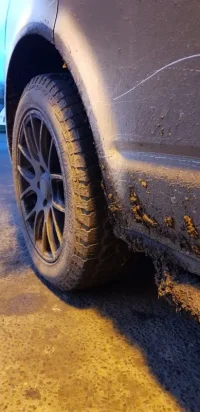

Do the tyres rub at all? with the 40mm drop
Do the Warlord's have a greater offset (smaller ET), than the standard VW wheels?, or do you run spacers?
No rubbing at all, but trying to decide if it will look better with a little more gap above the wheel with this tyre ?
I’m not sure on the offset I’ll check the boxes for info, I took advice from LK performance, who I got great service from.
Iv not got spacers on yet, but I’m thinking about some small spacers, as I’m used to seeing the 20s with 275s on the van! And these sit a little further under the arch.
I've got a 20mm drop with 25mm spacers all round with 235/60/17's (same radius as 235/55/18's), all seems to work well on mine, never rubbed yet.
But I think I'll go the 18" route, because well...., they just look better:thumbsup::thumbsup: imo.
