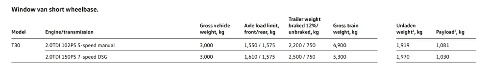

That translates to: Max permissible axle load 1040kg 960kg - which on a T32 should be obviously wrong.max. zulässige Achslast 1040 kg 960 kg
A T30 has max axle loads of 1500-1600kg.
It sounds like they're basing 29psi on 1040kg + 960kg = 2000kg. Is your van completely empty? If not, then that won't be the right pressure. My caravelle is closer to 2500kg for example.
