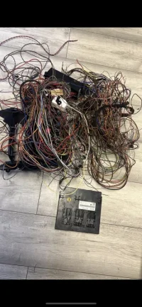

Sorted the charging accel pedal modifyed
Abs pump wired in
Engine starts and dsg gears work got to add part of bcm next to clear a few more faults
Exhaust/ brakes/ water piping/ intercooler / steering wheel and it’s a trail drive / had to add airbag module too , only awaiting on few bits and that will work great too
Main issuises off bcm issuises tbh couldn’t get dash heater controls to and power and bcm for gearbox

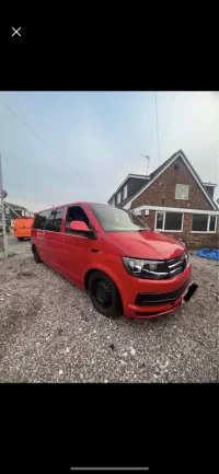

Finally managed some upgrades
Engine and dsg gearbox fitted,
T6 dash fitted,
Dsg remote fitted /
Loads off wireing / modules / ( still some more to do) but she starts off the key

Pics not showing, but fascinated to see more.
