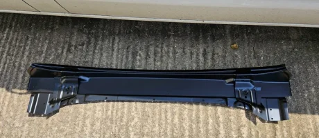

Ok so the inner panel just arrived. This is what is missing on barn door vans. You can see now that not needing to fit this extra lump of steel in a barney saved VW a considerable amount of money over the hundreds of thousands of vans produced without a tailgate. More than enough to keep the top executives at VW in strong supply of booger sugar and unicorn steaks no doubt.
Full width support. 2mm thick profiled brackets at the hinge points that stretch further into the roof area. These brackets are welded onto the full panel, so you have an extra 1mm of steel, thats 3mm of steel on this panel alone. Once fitted it will also but up to the roof panel and have an overall thickness of 4mm where the hinges bolt up. All the load spreading properties of the panel and the brackets make this an essential requirement for the longevity of a tailgate conversion.

The cross panel strengthening for the tailgate is not fittable retrospectively. It has to be fitted before the roof is fitted as it is sandwiched between the roof and the D pillars as they curve to match the roof line.
It can however be made to fit by cutting it in half, some detailed trimming and welding it back together once in place. Not ideal and to be honest a lot more work i dont want to do, but as im already here, i may aswell give it a go.

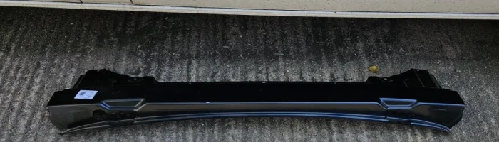

Here's the difference at the hinge mounting points on the van....
Barn/wing doors,
Tailgate,
As you can see, i did get around to washing the area :D
A 300% thicker mounting area on an additional full width cross member for tailgate vans over the barn/wing door vans.
