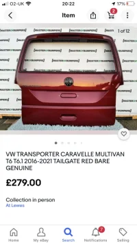

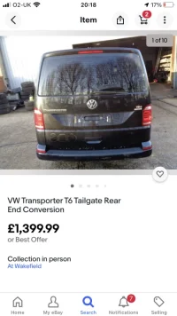

I’ve just had a quick look on eBay here’s what I’ve seen. There’s a full conversion kit with everything you need.
Or you can do as I did buy it all separate. My total buy was £850 for all the parts. The tailgate itself was the only 2nd hand part i bought the rest was new.
Although mine dosent have a heated rear screen or wiper so probably cheaper than if it did.
Good luck which ever way you go
I think I paid £550 for my tailgate and bumper. I sold the doors which paid for the LED lights.

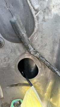

You'll notice the grommet hole for the harness to the rear barn doors is no longer used. I didn't have any grommets to cover them so I sealled them with some spare dynamat,
All done and much quieter.
