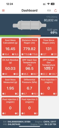

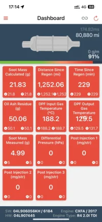

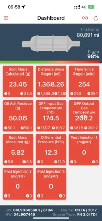

@IWMTom , I have a 2017 Shuttle (150) with CFXA engine code, currently using Group 3 on your app, but a few oddities with mileage, distance since last regen and soot levels. Could you add me to your Beta testing please?

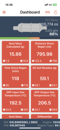

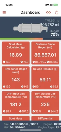

Hi Tom, I have a CXHA engine and I'm using group 3, is that correct? I had an odd value for miles since regen, but I think the time since regen looks OK and the other values seem to be of the right order. Having updated the app today the miles since regen is still strange. Screenshots attached, updated version is first. Both taken today. I don't have hyperdrive fitted, honest! Given the miles travelled in the top section the numbers look as though they are OK, but with the decimal point in the wrong place.
IMG_4671.PNGIMG_4669.PNG.
Am I doing something wrong?
