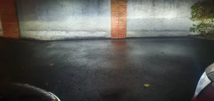

Picture taken from between two vans, both the same distance from the wall.
Left hand side are Bi Xenon Projectors fitted as an upgrade to the H4's on the right hand side are factory LEDs.
Thanks a million for the inspiration :thumbsup: !
