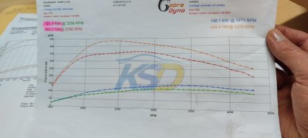

A tuner in South Africa got 146kW and 434Nm out of a 110psi 2l TDI T6.1 motor. So no problem with infinitely tuning the map. The 5 speed gearbox did not like it though. Final figures to get it right were 123kW and under 300Nm although the gearbox will take up to 320Nm without complaints. The holy grail is under 300Nm @ 2000rpm with a smooth torque curve.

Was that for a vehicle with the Bosch MD1 ECU though?
Quite possibly not...
Some [apparently] early T6.1 had the same ECU as the T6
In another thread, @Jacobsroodt mentions the above remap in the context of a 2024 T6.1. Presumably, then, either the Bosch ECU isn't used for the South African market (and therefore the above post is not relevant to this thread) or someone in SA has already cracked the Bosch ECU.
