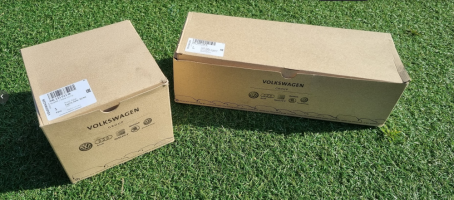

FWIW . . .
this picture shows some install sundries like bolts and bits as part of the kit . .
they also show £24 extra for the BiTDI engine variant?

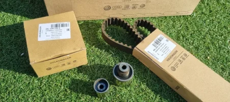

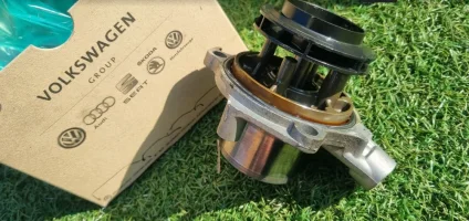

i asked them to keep the old removed bits to show you all, this is what they gave me back.
water pump - looks ok condition.

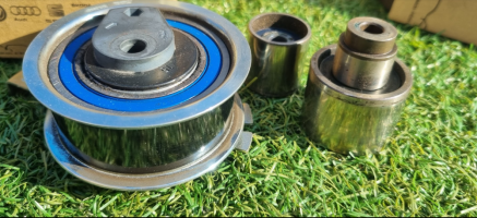

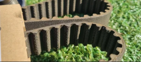

The Belt kit . . . . (belt, tensioner, rollers)
again all look superciliously fine . .
TBH, the belt looks brand new . . . . it still has the traction mouldings on the teeth and shows no obvious signs of wear.

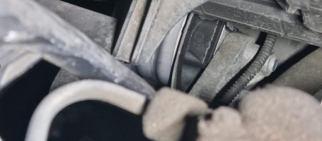

but can be clearly seen as fitted . . . for example the upper left engine mounting bolts have been replaced.

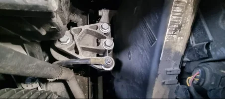

The FOC front lwr engine mount that was replaced . . .
They didnt give me any paperwork or the old one back . . . but you can clearly see a new one has been fitted.
front lower engine under radiator.

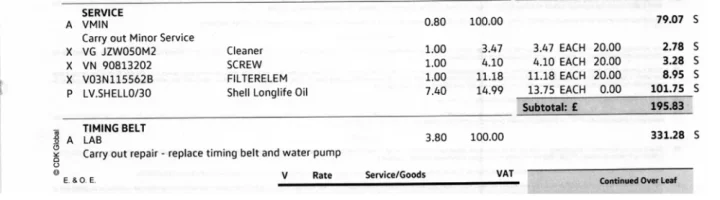

paperwork wise this is what we have.
They have made up one invoice that covers both the chargeable works.
service:
oil,
filter,
screw,
cleaner,
TB&WP:
timing belt kit,
waterpump
coolant
dist water
aux fixings
that all worked out
£410 parts
£410 labour
total £820+vat (£985)

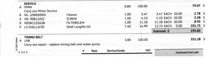

Gotta love how the invoice says "Carry out repair - replace timing belt and water pump" which infers that there was something that required "a repair" rather than say "UK customer = pull pants down at year #4 rather than year #5 like rest of world"
Funny, that was my first thought and I've voiced that opinion on here more times than enough, but @Dellmassive knows his stuff and I'd have done the same in his shoes, he's now got an extended warranty and if he needs it they can't escape liability by saying he didn't follow their servicing schedule.
