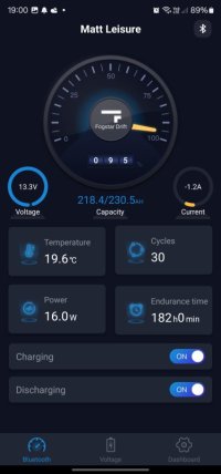

So 1 for the Victron massive. I have been having issues in that the shunt keeps stopping charging because it thinks the LB is at 100%. But the LB app says its only at 95%. I have reset the shunt to match but the Orion isn't starting to charge. Really starting to di my head in as I have checked it is getting an ignition feed to tell it the van is running but I don't know if the voltage settings are causing an issue. The van is charging but not ramping up as I assume the new starter battery is already topped off. Any ideas folks?

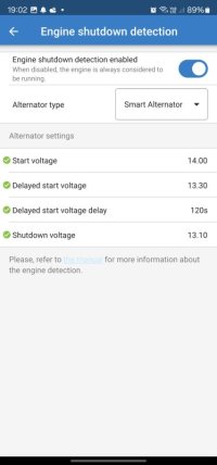

I think your shunt settings might need changing, these are mine:
If the shunt is syncing to 100% before the battery gets to 14.2v then that's a wrong setting somewhere.
