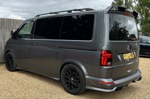

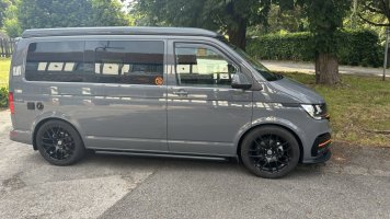

I had same as you Paul, Koni definition at 40mm drop which ended up being ~50mm with the 4motion/caravelle seat weight. 275 40 20 tyres.
Wow looks absolutely perfect . I'm keen on LV2s also. Are those staggered, if so is it 275/40/20 all round? I'm thinking 245/45/20 on the front...
Mine is a factory kombi so might not be as heavy as yours but might be closer than a panel van.
Not staggered. Don’t think it can be on caravelle due to door card hitting the rears. The LV2 are now sold… ha. Gone 17’s and although they don’t look as good, they’re more practical for my needs. Steve will sort you out. Nice chap too.

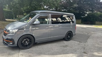

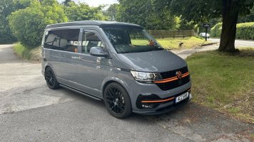

Thanks, thats interesting. I'm.on 17s now with oem tyre size. Have you gone for more of a swamper setup now then?
235 65 17 Michelin CC2. Resisted the urge to go AT tyres. They look cool AF, but I do lot's of motorway driving, interspersed with light/moderate off road so wanted a "do it all" setup. If such a thing exists...
I prefer the look of the LV2's, but again, practicality for me.
That looks great also thanks. I've questioned getting 20s for practicality if I'm honest, I've done the swamper thing and agree the ATs are not for me. I'm currently on 235/55/17 CC2's with stock T32 suspension. It good to see how the CRS kit works with your new setup, as I've often considered swamper wheels again with more road based tyres in a slightly bigger size. Would you say the comfort level increased going back to the 17s?
I only had this van for a week before going to CRS. And did 48 hours on 20’s with new suspension setup, all road miles and it was great (except potholes). Now on 17’s for a week and it feels slightly better over the same poor roads (potholes). But I’m confident when I’m down a track or in a field the 17’s will properly earn their worth. Hence the switch. If you’re on road the 20’s with CRS sorting suspension will be great.
