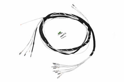

Hi guys,
I’m busy searching for all the parts for retrofitting basic ccs to my van.
My van is an euro6 2016 LHD. I’m in France, van is imported from Germany.
I found the steering wheel with buttons (coming from a t6) on eBay.
I have the new airbag harness with the button plugs (coming from a golf 7).
I need the extra repair wires I suppose. Can someone help to identify what and where to buy ? I can’t buy from England as brexit makes it complicated on eBay.

Hi, thanks Robert.
I’ve read this thread and sure this one helps me but There is no reference for the repair cables as he found them delivered in a full kit with cable for Mfsw to fix to the airbag harness.
I found this on eBay but no idea if it’s what necessary when fitting mfsw:
